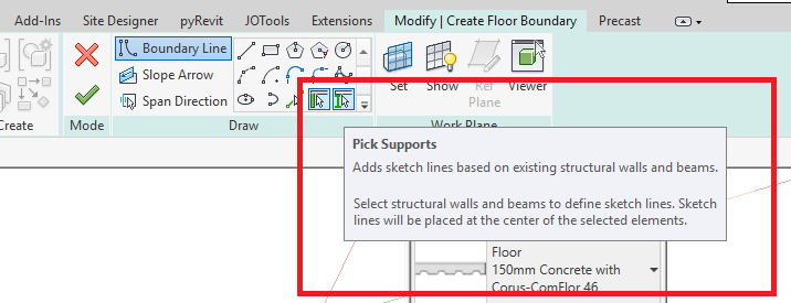

what is the best procedure to make with the analytical model in revit in order to have a clean model when its exported to robot ?

6) when you draw a slab use the pick support tool option. it will will help you place the anlytical edge of the slab at the beam analytical locations. otherwise some times the the slab edge goes beyond the anlytical beam locations and you may have to manually adjust the slab line.
