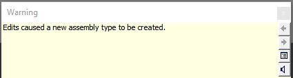

I've created an assembly that contains the Autodesk Family "M_Precast Column - Rectangular - Single Layer Difform Corbels". when copying or creating a new instance of this assembly a new assembly type is created, even though there were no edits made.
This happens both on Revit 2022 and 2023, and only with this specific family.
Any ideas why this is happening?
Thanks!

Hi Dan,
Our team looked into this and the issue is caused by the presence of 2D planar geometries in the family. More specifically, the Formwork Symbol family has a circular filled region in it. It looks like there is a problem when comparing assemblies containing non-solid geometry.
As a workaround, we suggest that instead of a filled region, you use a simple line to create the symbol geometry.
Meanwhile, we will look into how to fix this problem. Thank you for helping us identify this situation.

I seem to have the same issue in RVT 2024.3. I'm using the UK Precast Column - Rectangular - Single Layer Corbels, a few structural connection families in the assembly and structural reinforcement.
In specific Assembly K.A2 ought to be replicated 6 more times along the A axis.
I did try to remove the formwork symbol from the column family entirely, but the issue persisted nonetheless. I'm currently checking all families for non-solid geometries.
Would you be able to help?
