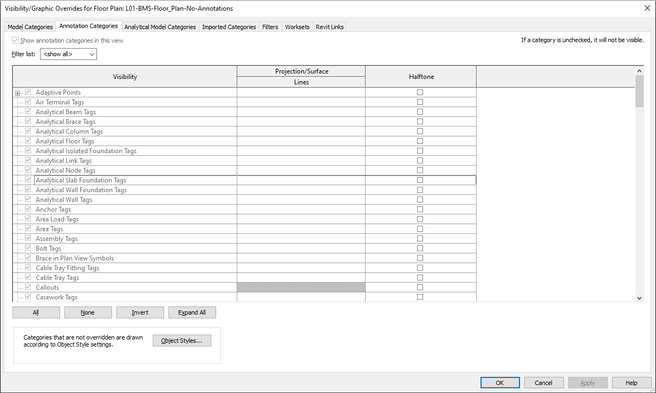

Here is my screen view:
As you can see, everything is "Greyed out" and I'm not allowed to edit
I'm still investigating so... if I stumble upon a way to do this I will update the post.
Thanks again for your help and pointing me (us) in the right direction..!! 😊

@Drafter1981 The greyed out visibility graphics indicate that the view settings are controlled by a view template applied to the view.
That shouldn’t prevent you from duplicating the view.
Find the view in the project browser, right click, select Duplicate.
Message 11 of 13
Drafter1981
@iainsavage   Yes,  I was able to create the duplicate page.. 👍  As far as the greyed out visibility graphics, I had to get permission to (a released central model) to change the view template and then re-sync. Seems the one floor I need to work on has a templates or fields that were locked down. All the other floors / levels have no (none) template:
