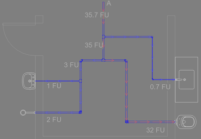

I know Revit can transfer the "Fixture Units" parameter conection by conection for the whole system, but, any way of transfering a custom parameter via pipes conections too?
For example, the next tube "receives" the length parameter of the previous one, I do a sum with it's length and It will be passed until the end of tubes.

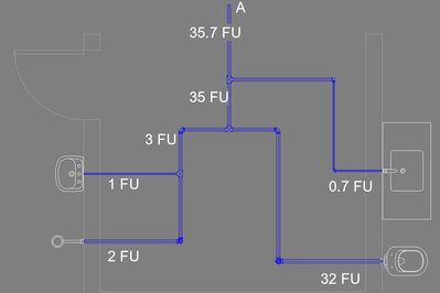

I'm working with residential cold water systems, and I'm trying to set up Revit to help me auto calculating values.
Look at this plumbing system that I created as an example:
Revit retrieves me the critical path showing me the most pressure drop path, in this case for the "A -> 32 FU". I can see more of the details when I generate the "Pipe Pressure Loss Report", but it results on the sum of pressure loss for the critical path only.
My problems:
1- I can't get the Pressure Loss Report for the other Fixtures (unless I sum one by one manually).
On the example, the shower is positioned at a higher base level distance than the toilet, and it also needs to be analyzed to determinate if the water pressure is enough on it.
2- I can't get the length of tubes for each path.
I could generate tables with the length being sum, but I could not make it sum based on pipes' path. Only for the whole system.
3- Revit uses Flow and Pressure Drop calculation methods different that I need. Sometimes the results are around 25% different from using my country calculation methods.
I would appreciate any help.

Revit does not make any allowance for static pressure caused by elevation differences and the only way that I can think of to do this simply would be to add the equivalent loss, based on a chosen datum, to each fixture or to a pipe accessory in the branch which feeds the fixture. E.g. a basin on the lowest story would have say 8000 Pa (800mm water gauge) added, the shower would have say 15000Pa (1.5m water gauge) added, basin on next story would have say 38000Pa (3m + 800mm) added etc.
It will however still only tell you the critical path which would normally be the only path of interest.

I inserted the loss inside the fixture connector in the family and it worked very well. Now the System Inspector is showing the shower as the critical path.
