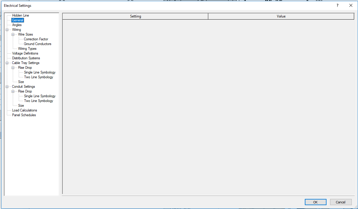

I have tried this for a few families but it didnt work. I  have loaded the families and the electrical panel into a new project and that worked fine.
Somehow my Electrical settings-> Panel schedules is greyed out.
Message 5 of 8
It looks from that last image like someone deleted all of the panel schedule templates from your project (or template).  Try this - open the original broken project and the new one that worked.  In the original one, go to Manage>Transfer Project Standards, select the new project, check none, and scroll down to Panel Schedule Templates and check that box, then hit OK.
Message 6 of 8
I have already tried that. I even tried to overwrite all the parameters, audit, purge etc.
Just noticed that my Electrical settings >> General settings have also been greyed out. I think something in the model is bugged.
I have run a test by upgrading the model from Revit 2016 to 2017 and everything works again.
Message 7 of 8
Whoa.  That's a new one.  Given that upgrading fixed it and creating a new model fixed it, I'd guess that you had a network drop during a sync and that data got lost.  Or the gremlins were particular creative that day.

The issue you have run into was fixed in the 2017 release.  A few other customers have also had their electrical settings deleted, but we don't know what caused it to happen.  We can fix your project and keep it in either the 2015 or 2016 version of Revit using special in-house builds.  Please contact support for assistance.
