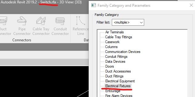

RobDraw
Not all switches in Revit are lighting devices. There are many things other than things lighting fixtures that are controlled by switches. This an OOTB family.
Rob
Message 4 of 9
sragan
Seems like you could just open the receptacle family, change the category to "light fixtures", save it as another family ( change the name in the file save box so you don't change all your receptacles), load it back into the project and use that family for any receptacles you want to switch.
