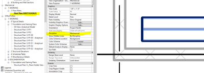

Yep.... must make a new Floor Plan in the Structural model and set the discipline in that Floor Plan View to Mechanical.  you may need to go to your Options, select User Interface and make sure the Systems Mechanical tools is checked. otherwise you wont get a Floor Plan option.

You make a Floor Plan.... Then, in the properties of the new view, set the Discipline to Mechanical.
