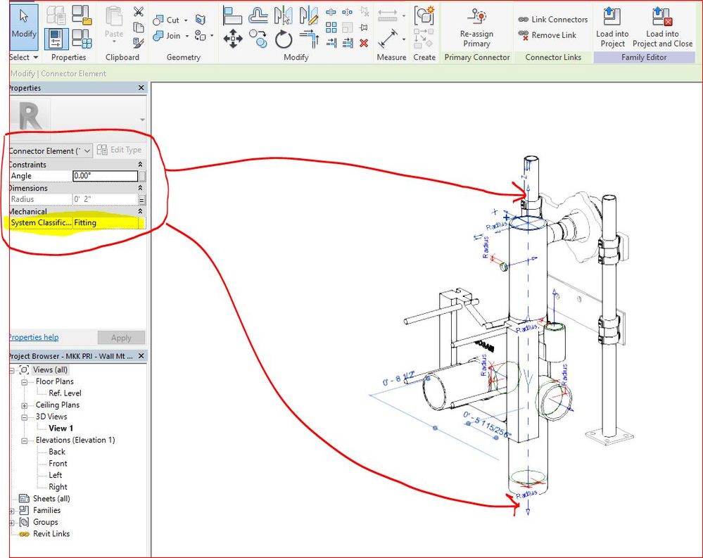

I have my plumbing fixtures reporting their fixture units, very cool, but When I go to connect a stack i don't know how to make the connector take the Fixture Units that the pipe is carrying and ad it up to it's own, I'm attaching a screen shot of a section where you can see that if I connect the plumbing fixtures to the pipes, the pipes carry the FUs (image left) on teh right you can see that the FUs don't carry when I pipe it as a stack. Any ideas? the connectors are linked within the family, Y just need to figure out how to add the FU from the pipes.
Thanks so much

Thank you soo much for your time, for that I'll give you "Kudos" but I don't think you understand my problem, I need the stack to the right to report the FUs just like it does the one to the left, meaning each fixture ADDs fixture units to the pipe, that way I can size my pipe at the end. At this point notice that when they are stacked it reports it's own units but doesn't add the units it brings from the fixture above it. And that is the problem, I had changed the connector to fixture to see if that way it would solve my problem.
Message 10 of 24
I missed the stacks the one to the right has to report like the one to the left. In short:
I need the pipe to continue adding FUs
Message 11 of 24

Set the top connector to fixture unit and associate it to an input FU parameter, change the connector to calculated, this way, this connector will read the FU from the pipe on top, then add the value from the plumbing fixture and set this value to the exit pipe.

Thank you for illuminating my mind I forgot this part "associate it to an input FU parameter,"   I can solve it @Anonymous
