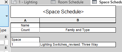

I made a quick test after enabling Room Calculation Point in the family.
Using Rooms I got the following schedule
Using Spaces
Fábio Sato
Revit do not show Room/Space from links in Component schedule.  You would need to create Spaces in your own model that utilize the Link as Room/Space boundary + Space Naming tool.
