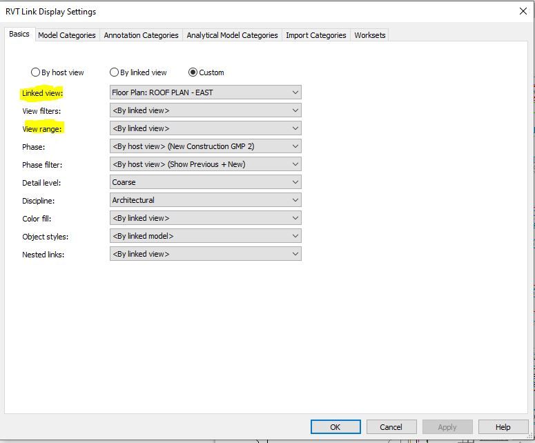

in the VG settings under Revit Links point the Architecture  Model to  a View from the linked model. Set the view range of the link to be by link.
iainsavage
If you want to you can also show items below the floor as dashed lines by changing the “beyond” line style.
