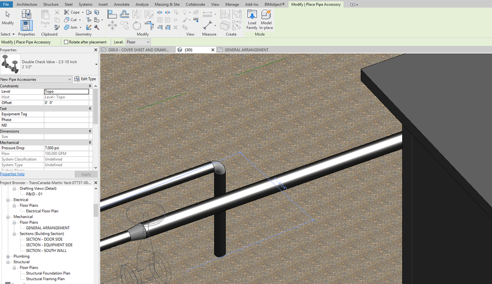

Revit 2019...
So one of the first things I created was a flow meter with instance parameters that allowed the flow meter to adjust to whatever pipe it connects to.
But now, all of a sudden, I try to place a pipe accessory, it wants to host to a level. And the family was never "work plane based" and still isn't.
If I click on System --> Plumbing and Piping ---> and "Pipe Accessory", you'll notice in the green placement ribbon, there's a pull down that looks at "Floor Level", and the options are the various levels of my project. It's ignoring the pipe.
This worked for 2018, and I even tried default "out of the box" pipe accessory stuff... Valves, etc... they all do this.
And that's a 3" line I was trying to connect it too, so it's not like I was trying to drop it into a pipe that was an unavailable size.
This example is an out of the box double check valve.
Anyone run into this?

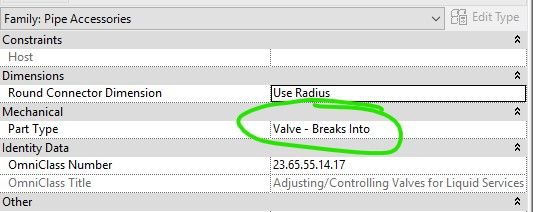

J.Wehmer
Inside the family on the properties toolbar

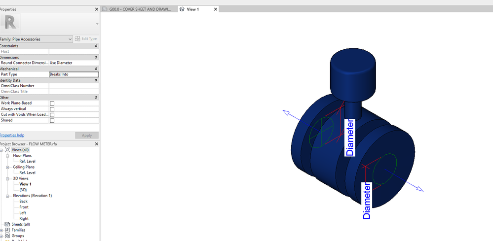

I was looking at that and didn't know if that was any different than the just "Breaks Into" option.
What I seem to notice, is that in my project, all my buildings are places at whatever rotation they need to be on a site plan. And I'm using a Scope Box rotated to match that angle, so I can associate my views to that Scope Box and work orthographically. I try to bring in the part and it seems to want to read the skewed angle through the scope box. Thus not lining up my component with my pipe properly (like 3.5% rotation) and not treating the pipe like it's something it should not be connecting to.
I started a new project, drew a pipe south to north, dropped the same flow meter onto it and it worked like a charm.
mroble
@J.Wehmer
This seems to be the issue.
Went into the same project, dropped it in again, but this time, I zoomed into my pipe and it placed perfectly fine.
It "seems" like being zoomed out, it was reading an angle off some component and lining up and holding onto it.
On one hand, I love how Revit wants to line up with things, on situations like this, not so much.
