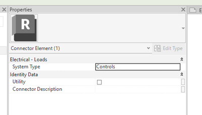

When you say " If the points are not in the model " , do you mean the actual control points based on the electrical connector in families? Or what exactly?
The "Controls" type doesn't really seem to be very functional. I've been trying to do a better automated way to connect thermostats and other devices, but I didn't see a good way to leverage control points. If you found a way to use them better, I'd be curious how.
