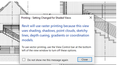

i get the following dialog box when hitting CTRL+P
if Black Lines is chosen, it might result in the problem you are describing.

iainsavage
What is in Advanced settings here?:-
"so the Vector option in the Print Setup does not ensure Vector?"
There's a setting in Revit (can't remember where) which allows automatic switching to raster if the view contains any shading.
Message 12 of 30
iainsavage
It will switch automatically from vector to raster if the "Do Not Show This Message Again" has been previously ticked.
Message 13 of 30
curtisridenour
But that should only be a problem if you have transparencies, NWCs or the other list of nonsense below.
https://www.autodesk.com/support/technical/article/caas/sfdcarticles/sfdcarticles/Revit-will-use-ras...
Does using the Bluebeam addin ensure that Vector Processing is always used no matter what the settings?
Message 14 of 30

iainsavage
The most usual cause would be if any of the views on the sheet are set to Shaded.
Using Consistent Colours should prevent automatic switching to raster mode.
I doubt if that has anything to do with printing black instead of greyscale though.
