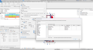

@ipiotis_dinos You can achieve this using a combination of Revit 2023 and later built-in feature and DocumentViews that recently have been added to ThreeDeltaTools - The View Collection
See the procedure below.
With Revit 2023 or later you can export to pdf and control the exported file name with predefined parameter-driven settings as shown below.
With DocumentViews, you can automatically manage view names by applying similar predefined naming standards that are driven by parameters and their abbreviated values. With this tool, you built a list of parameter camelcase values and their corresponding "abbreviation" to be the expanded one with spaces.
e.g
Parameter A would have a value in the predefined list of values you set with DocumentViews as
 "FlatType01" with abbreviation as "Flat Type 01"
for Parameter B
"DomesticWaterServices" with abbreviation "Domestic Water Services"
The DocumentViews will automatically manage the view name and set it to
Flat Type 01 - Domestic Water Services
and you can use Parameter A & B above (their values will be the camelcase ones) to setup an export to pdf rule.
I hope the above makes sense.
