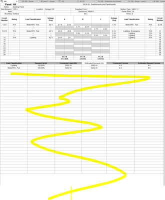

OK, I figured out part:
How do I make it only show the rows that actually have a value? and not all the empty rows (highlighted)?

I'm not sure what you have done to get all those blank lines. I usually have the schedule show "Only Loads that are Connected" and then it doesn't show a bunch of rows with "0's".

The schedule editor seems to be straight forward. check load summary in general settings, and only connected loads in Loads summary
but it shows me as many rows in the real schedule as it shows in the schedule editor. I couldn't find some other setting that would change this.

I still have the same issue. but I also came across this issue that the total load is wrong (in my case 10 kVA shown as opposed to 23 kVA!!!).

Yes, the classification is assigned in the family. I didn't see a way to assign it in the project.
Are you saying the panel schedule load summary will show as many rows as there are load classifications in the project (from families, or from the electrical settings)? I was hoping it would only show rows for actual classes connected to that panel.

I got closer to show the load summary properly. My solution was to delete the additional rows in the schedule editor. By default ti shows 20 or so rows and I deleted all but the top row:
One wrinkle is that borders around the cells don't work if I have more than one load classification on that panel:
And yes, I tried applying the borders. Do the borders work for anyone for this? what am I missing?

Borders seem to be a little iffy if you delete the outside rows.

I tried to remove the load summary, and the re-apply. but it now doesn't give me the 20 or so rows. I basically gives me what i had before after deleting the useless rows.
I probably should have deleted the top 19 (and not the very bottom) row. Looks like a little bug what they did, IMHO.

Sorry for the lates response - the panel schedule load classification area should only show LC's that are actually assigned. It won't include anything that doesn't have an associated circuit or value.

Don't delete the LC rows in the template - that sets the maximum number of listed load classifications. The default templates have about 10-20 in them based on the template/sample projects, but the schedule should shorten this up to only show what is used.

For me the problem was that it showed all the empty rows. But after deleting them in the template, it automatically shows as many as are connected to that panel.

Yea, to me, the large size of the panel schedules on a sheet are a problem. And there doesn't seem to be any way to trim them down to the size I woudl like to see them without running into problems, like the borders not working right.
There always seems to be a ton of space at the top of the schedule too, and I've never been able to trim it down to anything reasonable.
