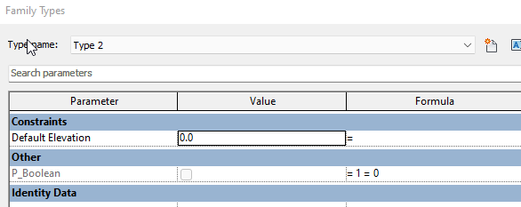

What I normally do is the following
-In the family editor I create the different types.
-I add visibility parameter(s).
-I add a formula 1=0 (to each visibility parameter) if I want them all off.
 If you now go through the different types they are all off.
-Remove the formula and start setting them as desired.

The method of =1=10 works for what I need - hopefully they add the ability to do this quicker in a later version.
