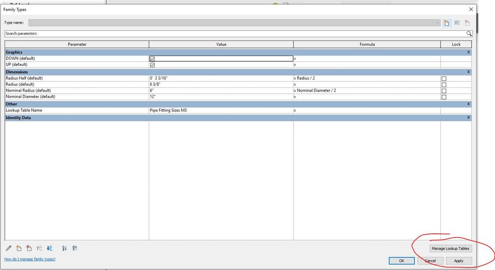

They would be located in the file structure for the family. If the lookup table is loaded in the family you can find the file location looking under the parameter dialog box.
