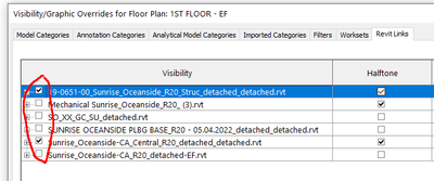

efoxSMI
Did you look at the Revit links tab in your Visibility/Graphic Overrides or in the view template?  That link could simply be unchecked in your view.
