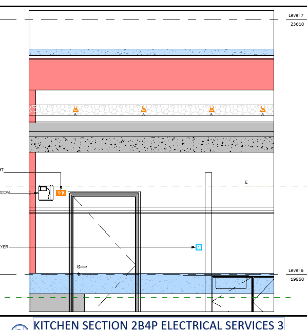

not sure what i've done but i've got a linked model in 1 project but multiple sheets and now on 1 of the sheets the linked model level is lower than it should be how do i move it back up to the required level without moving it on the other sheet ?

Going back to your very first image copied below, the misalignment of level 0 is just because the views on the sheet are out of line.
If you drag one of the views up or down a blue dashed line will appear to show that the section views are aligned:
Then release the mouse and the views will align horizontally:
In your second image in part 3 of your post you'll see that level 6 is at 19860
Then in this next image from one of your pdfs both views of level 6 are also at 19860:
So I'd conclude that the levels have not changed and they are not appearing differently in different views, its just that the views on the sheet are not aligned one to the other and this can be corrected by dragging one of the views up/down until the blue dashed alignment line appears.
