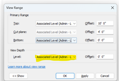

We have the architecture's file linked into the MEP drawing, but when we worked on certain floors, some of the lower floor fixtures keep showing on that floor. The view range is set to that certain floor already. The circled fixtures are not on that floor, but still shown.

Screenshot your view range settings and post them here

Here is the view range, all the top, bottom and cut plane are referring to the third floor. The locations are correct. It is showing the third floor itself, and the Plumbing fixtures on the 1st floor and 2nd floor.
On 2nd floor, it will show the 2nd floor itself, and fixtures on 1st floor. So it is accumulating information from lower floor.

Is the View Depth also referencing the same level as the main range settings?

Respond to second bit though please.
Expand this drop down - what level is it referencing?

Here is the screen shot of the view depth reference.

Hey, all. Problem solved. I set the view range setting to host view in the link setting, and it solved the problem.

you probably cant edit the view range in the arch model because there is a View Template applied. the View Template is probably locking the view range.
