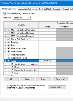

how can I show the middle dashed line?
second how can I show the yin yang/ cross sign to the vertical pipes?
Do you mean the pipe center line? That is a view setting and can be found in the V/G Overrides.
That is in the Type Properties for the Piping System(s).
Rob
to show the middle dash line you should activate the pipe centerline as shown...
for yin yang, you can choose it from piping system type properties as shown
