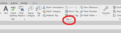

I would like to know if there is any way to make a pipe tag to identify if the pipe is a riser. I have to make 2 different pipe tags: one to tag pipe risers and the other to tag a horizontal pipe in a floor plan. However, I always have to change the tag type for every pipe riser or horizontal pipe (image as an example), which is tedious for me.
I want to click "Tag by Category" and it automatically decides which Tag will be used.

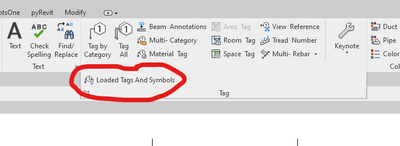

The element category is pipe.
It will use the currently default tag type for that category.
You can change the default type here:
I suggest:
  • Set your horizontal type to the default, tag your horizontal pipes.
  • Change the default type to the riser tag, tag all risers.
