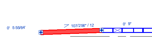

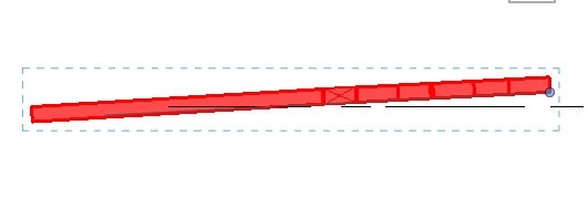

hmunsell
I tried the reference plan option and I was wrong it didn't work :-(.
from what I know you can edit individual elements, but not the whole run.

Message 7 of 12
It took some doing to do it by selecting the whole run and rotating it, but it worked.  Thanks a lot.

RobDraw
I think you may be missing part of the equation by rotating the entire run unless you did the math beforehand. Rotating the entire run so that your slope is correct between the start and end points does not account for additional length created by the bends but that isn't hard to figure out what the rotation angle should be with the additional length.

RevitMEP does not has a way to do an odd shaped and sloped duct beginning with the drawing of a line  that follows the path, and then which you can also (in addition to know the length of the line) assign the slope to the line, and then easily convert the line with just the click of a tool or a command, to a duct?
Message 10 of 12
RobDraw
No, it is not that easy with duct but it is fairly easy to find out what the difference in elevation should be for the entire length of the run and then figure out what angle to rotate the entire run to.
Rob
Message 11 of 12
I believe that what you are saying that the length that is to be used to get the lower and upper points of the ducts with the odd shape is the sum of the lengths of the lines of the legs (sides) of a triangle (for instance, assuming 90 degree legs for the sides for simplicity) rather than the length of the hypotenuse (that is, do not use the diagonal!).  Is that correct?
Message 12 of 12
RobDraw
Yes.
