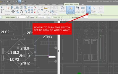

You must be doing something I am not because there is no way to turn the change the slope or elevation button off in plan view, as I stated in me previous comment!  When drawing conduit in a plan view, I don't want EITHER control on.
I hate drawing conduit in Revit.  5 Views are required for routing conduits.  Elevations are best for viewing and 1 3d, and a plan view, setup to see the top and bottom of conduit, if that is possible.  A pain to setup and get right for sure.
A connector is required on boxes in order to have start and end points.
Placing a default conduit connector starts of with a default of 2'. NO SUCH CONDUIT EXIST!  Change it to the minimum of VDC detail, usually 1".
Start drawing conduit from an elevation.  Here is the first screwup in Revit.  My intention is to get conduit out a box, top or bottom.  Oh look I can't do that!!!  DANG IT.  Only chance I have to cancel because you know know better than me.
Ok, lets try to draw a conduit from top view.  Step 1 select a connector.
step 2 select height, so far so good.
step 3, the ****ed off stage of getting conduit a starting point.  that didn't work either.
At this point, revit doesn't like what I want to do.  Imagine a work flow of 100's of these these problems on a large project.
Like I said before I hate running conduit because it doesn't work.  With the thought us running multiple conduits from one room, do you expect users to route one conduit from start to finish with a forced workflow?
The switch I have highlighted toggles from add verticle or to change slope.  I DON"T WANT EITHER.
Well, no, there isn't. What else could there be? Either add a vertical or change the slope, how else are we going to connect them. For now we're confined to our stupid three dimensional space.
You're getting "no auto route solution found" error either because your conduit type settings aren't setup properly, or you're trying to cram them to a space smaller than the fittings can fit.
There are many quirks and Revit "rules" which you have to follow, but people are running pipes, even sloped pipes, even on large projects. Conduits should be even easier.
I can turn off automatically connect but not slope or vertical.
Again, how do you plan to connect them, if by neither a vertical nor a sloped one?
