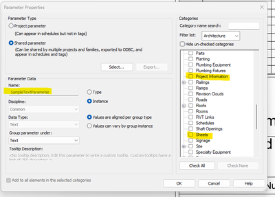

There need to be built-in or Shared Parameters in both the title block family and the project to allow you to edit that information.
If they are missing then when you select the title block you will see question marks.
You need to load the parameters into the project
and then associate each parameter to either Project Information (this wall have one value on all sheets e.g. the project name or project number etc) or Sheets (this will have a different value on each sheet e.g. the drawing number)
