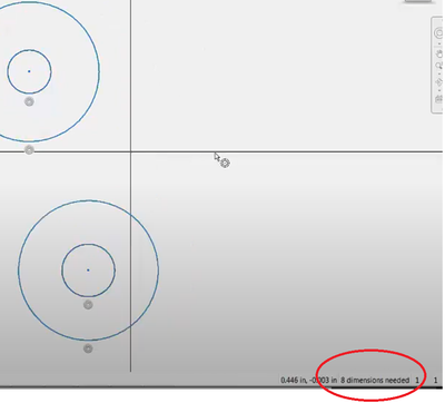

Trying to make constraints for families. I used to use inventor in school, and it was so easy to make an object completely static with help from the "dimensions needed" display in the bottom right.
Anything like that for revit, and if not, is there a work around that can combat human error.

No, it is a matter of "flexing" the family and see if it behaves as expected or that it wil break. And if you do it properly you then load it in a project and do the same and see if it behaves there as well. If it is a complex family you should do it not only at the end, but also some steps in between.
Often I start first with a framework of reference planes and lines and constrain those before adding geometry.
