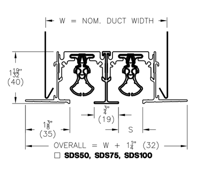

Typically architects don't care as much for the face size as much as they care about the size of the opening. Mostly because they like to use the frame that conceals the face and only shows the slot opening. I did some research and this is what I found. According to their literature, a 1" slot is supposed to be the W plus 1-1/4" SDS100 which is the 1" slot is 2-1/2" plus 1-1/4" making it 3-3/4" width.  In the example, I did the 1" slot using their SDS100 product. We typically call in our schedules using their description recommendation that goes as follows: Unit length, Outlet type/model, number of slots, border style, and accessories. For example, a 1" ceiling slot will be SD100/1/8/B12. we don't call the unit length as they will vary and change often depending on the application and with all different sizes, we would have to create individual grilles to our schedules making them very massive. I'm not sure if any of this makes sense

If its the Slot width that you want to see in your label/schedule then that is the parameter that you want to include but you are using the Size parameter which is probably the neck or connecting duct size rather than the slot size?

Your problem is that your tag is reading the duct width which has a minimum 2".

Add a new Shared parameter.
Use a formula to make that parameter's value equal to the existing Slot parameter:
Save and load the family into your project.
Then create or amend an air terminal tag family.
Add the same shared parameter to that family and include it in the label.
Load the tag family into your project.
Result:
This is just an example, adjust/amend to suit your own needs.
PS(1): the slot width is not actually what will be seen on the ceiling - you'll see the face of the diffuser which is 3.25" so I hope the Architect is aware of that.
