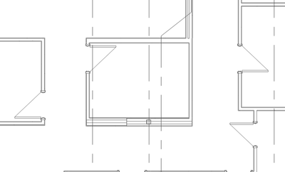

So this has happened on a few of our renovation projects recently where we have existing services in a .dwg CAD file and we only spend the time to recreate in Revit whatever existing services are needed for our current project. We use a linked full architectural model set to underlay and link the CAD file to show in the views as needed. For instance, this is a section of a plumbing demo view where all piping is in the CAD file:
This is all well and good, albeit a tad clunky to have to jump between AutoCAD and Revit constantly. However, it gets weird when printing/pdf'ing. We are using Bluebeam and when it's set to use vector printing (ideal) all of the CAD objects are invisible.
This also happens when using Microsoft Print to PDF so it's not a Bluebeam issue.

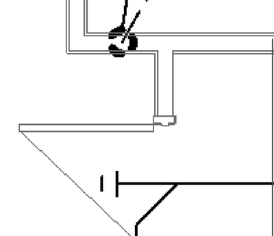

The CAD content only shows when we change the print settings to raster:
Unfortunately, when you choose to print in raster, everything is in raster:
Nothing was changed between these two pdf's besides the choice between raster and vector. Printing settings:
This project is particularly bad at this. In another project this year the CAD lines would only disappear when passing through a wall in the linked arch model so that seemed it was plotting the arch model on top of the CAD, but in this project all of the CAD is gone.
Any thoughts on this? Our only solution has been to limit the sheets where we rely on using CAD files (like just for demo) and print those as raster separately, but it would be great to be able to just use vector.

Well I feel like an idiot. I was trying to figure out how to move the CAD import vertically up (still haven't figured out how), but I did see that the Draw Layer was set to Background. Changing to foreground and it works
So seems for some reason, when doing Vector printing and the CAD import is set to background, the Arch model prints on-top of the CAD, forcing me to use the raster printing. When the CAD is set to foreground then it'll print correctly regardless of raster/vector.
