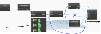

All,
when attempting to run this, the following error appears:
FYI, am a newbie when it concerns these programs.
Message 6 of 9
RLY_15
Please post the rest of the graph. You might be miswiring the IN[2] input (should be pulling from All Elements of Category) but I can't tell without the rest.
Message 7 of 9
JayHagan
Here is the Graph.
Thanks.
Message 8 of 9
RLY_15
Message 9 of 9
JayHagan
Awesome,  Thank-you that worked.
