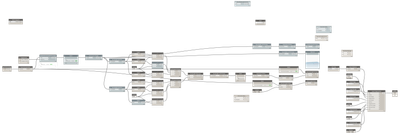

@L.Maas Thanks once again! Figured out how to use dynamo! Now running into problems again. It seems that when I redefine the bounding box to feed into creating a new setcropbox function, it throws up an error. I have no idea how to solve it. The original bounding box doesn't have problem in creating a new setcropregion. In fact, when I deconstruct and reconstruct the original bounding box for some reason the View.SetCropBox node breaks down again, even though the bounding box is exactly the same.
Oh lordy, am I getting frustrated. I am attaching the dynamo file. As soon as I can figure this out, it will be a major hurdle surpassed in the right direction.

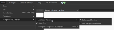

Thanks @L.Maas for the assistance again. Yes, I tried that script out, but it seems the problem is that the MEPover library node SetCropBoxCurves does not change the view crop region. In fact, besides the blue outline that appears with the geometry preview, I do not know what the cropbox actually means. I tried this out with the ExportImage plugin from Archi-lab. The ExportImage node recognizes th elight blue lines in the preview, but when I turn the preview off, the recognition of the "border" stops.
@iainsavage The error that occurs when I try to set the crop box is a null object error.
Edit: To clarify I end up with this result:

Yup! Min and max are fixed, thanks for that. Here is the current dynamo graph.

This is the "crop box" in Revit
When actrivated it hides the elements outside that box (the annotation crop is to hide some annotation elements)
If you see something blue highlighted in Revit it means that it is selected or it might be a preview from Dynamo
