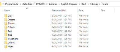

hmunsell
the file you sent has not fittings in it..... there should be categories like the image below.
Your model only had Duct and Pipe categories... no Duct Fittings or Pipe Fittings.
when I load fittings using the Insert ribbon, Load Family tool the fittings show in the routing preferences.
Howard Munsell
Message 23 of 37
hmunsell
I loaded families from my out of the box library (C:\ProgramData\Autodesk\RVT 2021\Libraries...) folder.

lucaswillianmds
Thank you very much, it's helping me a lot. Could you show me how to load connection families, preferred connection type, junction, crossarm, transition, union and cover. Show in the library which families I should load.

hmunsell
same method, just pick the folder hosting the content. I'm showing the English Imperial folder, but I'm sure there similar in other languages.
