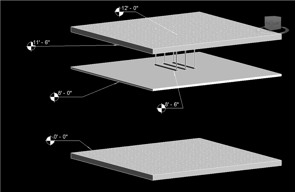

I have attached a screenshot of an example at the bottom. I created a quick hanger family that is strut with two rods going up. Then made this hanger three families of different types (Specialty Equipment, Pipe Accessories, Generic Models).
The multiple views are the different view Disciplines. You can see how they all show the hangers differently. The reason Specialty Equipment doesn't show up is because the view range cuts off before the end of the rod. I always cut my views off before they get into the 2nd floor slab. Since all the hangers are in the floor so that doesn't allow them to show up. You may do things differently just telling you my reasoning. Below you can see a 3D view and the view range settings (These are the same for each view).
