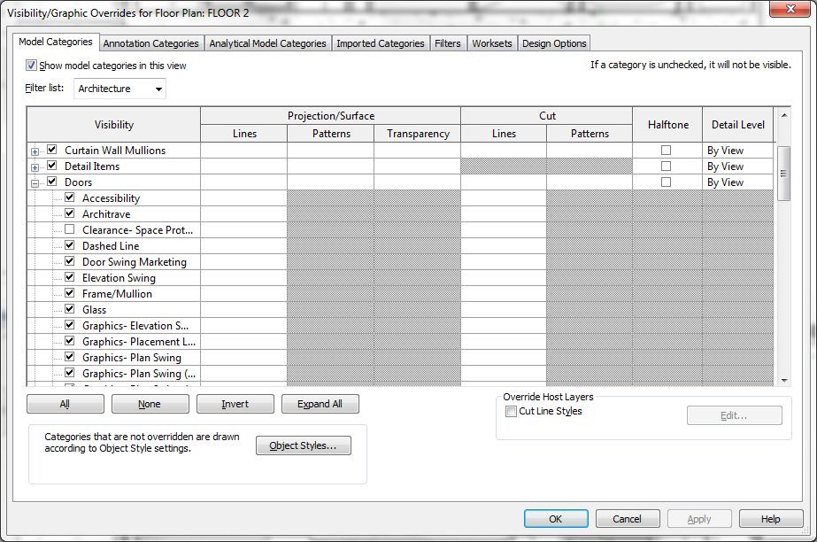

I have a model, with hundreds of doors, showing their required clearances, on plans and 3D views.
I do not wish to see those , ever.
In the model is an option to uncheck Door > Clearances
In my MEP file, where the model is only an Overlay, that option does not exist.
Question, how to get rid of this?
I do no want to upload another image, the clearance of the doors show as a hidden line, and plot/print as well.

Go to your revit links tab. Change the setting to custom and then go to the model categories tab (of your revit link).
Is it available there to be turned off?
Yes! In that Revit Links tab, after I clicked 'Custom' , the Door / Clearance were present and could be unchecked.
Many Thanks.
