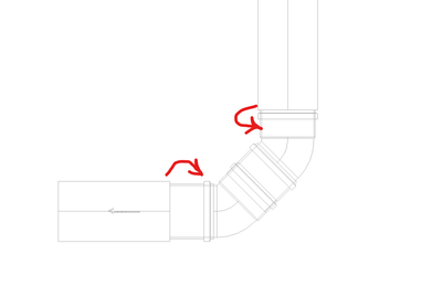

I think you want to relocate the connectors as shown by the arrows below

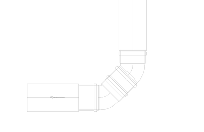

When viewed in hidden line mode most of the fitting is invisible (masked by something in the family?)

Regarding your comment about the positioning of the connectors, you are correct. I need to reallocate the connectors, but I left them in their current positions while trying to solve the slope issue.

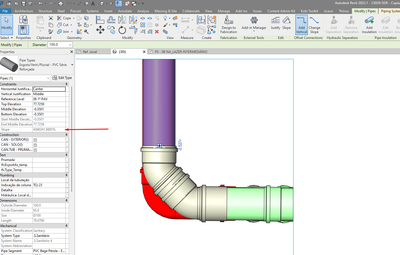

When I insert the custom family, the slope of the vertical pipe (stack) sometimes changes to an unrealistic value, as shown in the attached image.

I think it could be related to you swapping out the fitting and the dimensions of the fitting and location of the pipe ends being different from the standard bend so Revit tries to flex the pipes to suit the change in geometry (but that's just a guess).
I also noticed that in the family the bend angle is always 90 degrees and does not flex for different pipe angles - it relies on the "allow slope adjustments" option  to allow pipes to have slope - not sure if this has any impact on retention of pipe slope value though.

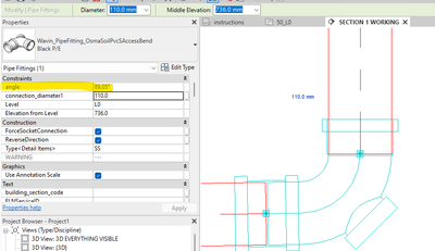

This bend flexes to the pipe angle:

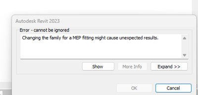

When I swap this fitting for yours I get this warning which usually means that there are alignment differences and it won't actually let me complete the swap, I can only cancel the operation:

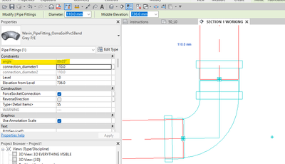

But if I swap it for another bend family it works okay and retains the bend angle and pipe slope:
So I would conclude that its probably because the angle between connectors in your family is not controlled by the pipe angles.
