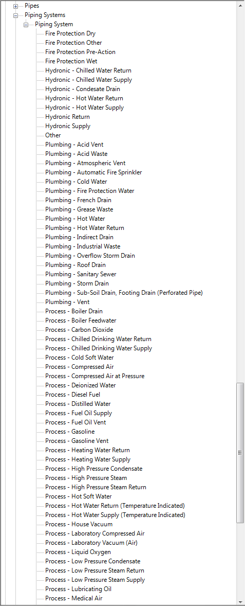

I am trying to change the system classification on a piping family to create new System classes.
However, when I duplicate a piping family, I can not edit the System Class. I am attaching an image of it below to better give an idea of what I am trying to change. My goal was to duplicate the Sanitary line, then make it into a Drain Line so that way we can tell the process drain lines apart from the Sanitary lines in the model.
What must I do to get it to the value I want?

As you've found, you can't add additional piping system types, you can only duplicate the default systems. The process you described to create your drain system is the correct process.
Default piping systems:

Correct. From what I've found, as long as you duplicate the correct system type, you can create any type of piping system you need. Here's a partial list of the systems we've created using Duplicate:

First you set up your desired Piping System in another Revit project and name that Piping System same as the Piping System you want to change in the other Revit project,
While both projects are open in same Revit or source Revit project is linked to destination project, select Manage/Transfer Project Standards,
Select source Revit project, select Piping System Types, click OK, click Overwrite
Done.

You have a "PROCESS" clasification that i don't. What system did you duplicate to get it?
