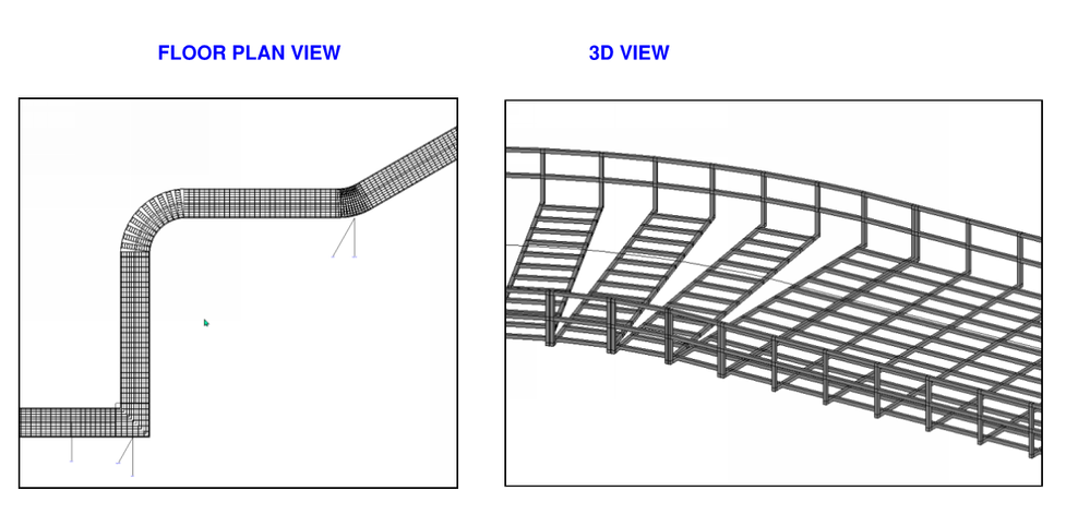

Fabrication MEP has basket tray. You can load and modify them as you need it. Let me know if this is what you are looking for and I can walk you through how to load and modify the basket tray.

 That was correct, I can't change the appearance but can modify some parameters that was greyed out. Hope this helps.

yobry
I resolved this problem using filters with a custom pattern and transparency. It's not perfect for the rendering for example but at least I keep my cable tray in the system category (allows schedule, etc).
