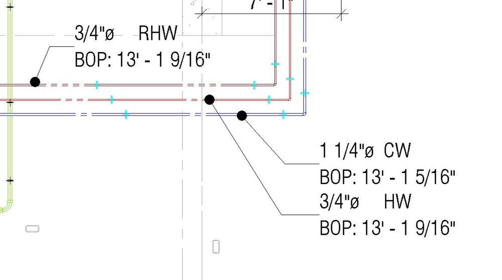

I am an MEP BIM coordinator and need to come up with an annotation that labels the bottom or top of pipe.  The actual diameter of the pipe matters so using the invert elevation parameter does not work in this case.  Does Revit offer a parameter to use that gives you the bottom of pipe OD (outside diameter) and allow it to be relative to the level the pipe is on?  If it doesn't i am a bit puzzled why not as this is something the MEP coordination industry needs to get proper drawings out to the field.  Please do not give me solutions with Dynamo as i don't know this product and don't have time to mess with it.  This is something that Autodesk / Revit should give with their base package - no excuse to not have this.  If this was in another topic post forgive me but i have searched and couldn't find anything that answers this.  Also i know the spot elevation tag does this but i want to create a full annotation tag that has pipe size and type on it as well instead of having to tag or annotate the same pipe twice.

Thank you guys for your input.  I have used the spot elevation tool but it only gives the dimension so i have to tag the pipe again with the actual pipe type and size which is double the work.  That is why i wanted a parameter for it so i could combine the tag elevation with the size and system.  The Dynamo script i was given allowed me to set up the parameter and add it to my tag.  My issue has been solved unless you guys have influence to get the Revit team to add a bottom pipe and duct parameter.   I just think its such a simple thing to add for something that is industry standard - just not sure why they ignore this and have everyone scramble to work around it.  See image below for what i needed.  This is what my pipe fitters and plumbers wanted.
You could edit the elevation tag by adding labels assigned to the size and system.
Rob
Message 20 of 37
That is what i did.  Just needed the proper bottom of pipe parameter which i was given from the Dynamo script.  i was just venting again about that parameter not being available with the standard selection of parameters.
