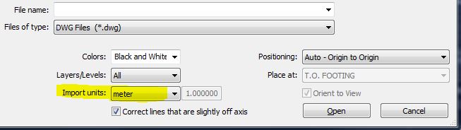

HELLO 🙂
If you still have this problem here are solving ..
when you import hatch from cad  make sure that imported unit file in format window  like current revit unit . for example if your revit unit is in (meter) when you import cad determine (meter) in window >>import cad format<< ( shown in screenshot )
if it Succeeded please tell me. 😄
Message 8 of 25
Thanks for the tip. I have it as auto-detect, not sure if that is right or I should manually do it everytime. It's a relatively small project so I'm going to cave for now and just manually put in the hatching. I would still like a better solution. I was thinking it might have something to do with my line weights, however I don't know what I should be changing and to what.

Message 14 of 25
Actually every time I determine meter in cad format  the hatch appears regardless revit unit I tried it many times after I was facing your problem
try it again 🙂
Message 15 of 25
yes I found matching doesn't help but i tried to make imported unit in meter regardless revit unit and it worked
Message 16 of 25
scrosley
Changing it to meters only changes the scale of the hatch larger so the lines of the hatch are spaced wider apart and is viewable however it also makes the line widths all appear thin so you would have to modify the "View template" if you use one. Unfortunately the only solution I know of is to explode the hatch (good for revit import but not good for your autocad detail file) I find this to be the case with some mtext too. So maybe you have to have two detail folders one for Autocad details and another that is used for revit import.

mmcdaniel
CONFIRMED: I was having trouble seeing hatched regions when importing using "Auto-Detect" import units. After switching to "meter" all of the hatched regions showed up just as they appear in AutoCAD.
