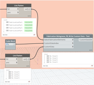

craigjonnson
We created an API for this exact same thing. Im not the developer of this app though. I have had this working using the Fabrication Bolognese dynamo package, you should be able to find which Revit API it uses from that package.
And dont quote me on this, but check out the API SetPartCustomDataInteger Method (revitapidocs.com)
Additionally, this should be posted in the API forum, you will get better help in there.
