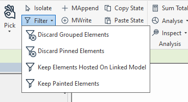

@leilani.gnall-gregory , if you select "all in project" and then can't edit an instance parameter because some are in groups then pyRevit plugin is a life saver, it has a tool to remove items that are in groups from the current selection...
