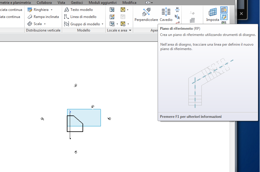

there's possibility to cancel work grid?
What change between work grid and reference plane?
Are similar to use?
Thank's

Use "Show" workplane button on the Ribbon to toggle it On and Off.

  1. Yes is possible turn off.
You are in sheet view to see this kind of grid  (Guide Grid)  (checking your image Work grid.png)
To turn off or on you need go to sheet and don't select anything.
Go to properties tool and in the last line you can change GUIDE GRID to none.
2.
Guide grids help arrange views so that they appear in the same location from sheet to sheet.
You can display the same guide grid in different sheet views. Guide grids can be shared between sheets.
The reference plane  is guideline in your design you can  host object in this references planes.
