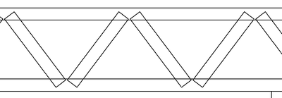

what's the best way to trim the webs of wood trusses?
to look like this:

Did you try to use Cope? or use a reference Plane to cut?
utech.udara
Following Forum discussion might be helpful to solve your question!
https://forums.autodesk.com/t5/revit-structure-forum/miter-joint-in-timber-beams/m-p/10486104#M44451
Cope Webs to Chords and zero out the Coping Distance.

thank you.  forgot about that command.
thanks.
