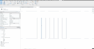

I just graduated from architecture school so please bare with me as I only have a few years of Revit under my belt. I am having trouble with cutting into wood stud components. I have recreated the studs through a structural column, architectural column, casework, generic model components and tried the cut function but nothing seems to cut out the window.  Is there a way to achieve this? I am wanting to do a lumber take off too, so the framing needs to be as accurate as possible. The 4 studs bunched together are different types of components that I mentioned.

You can use a void to cut with or the split tool ...depending on the element you want to cut
An easier and more common way to do this is to use a curtain wall its mullions only and empty system panel..you can either edit profile to generate the cut or u can work with grids segments...Curtain wall mullions can be scheduled and the cw itself can also host windows and door by replacing a panel...

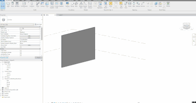

Did you use a Beam System for the studs?  If so, and the Beam System still exists, you can edit the Beam System and add a sketch the boundary for the window opening inside the perimeter boundary.

Create a Work Plane by drawing a Ref. Plane in Plan View and naming it.  Then in 3D View (or Elevation/Section View parallel to the RP), set it as the Work Plane to draw on using the Set Work Plane tool.

@barthbradley  I was able to get the work plane verticle but when I cut an opening in the sketch, the beams rotate where they meet the window
Nachricht 9 von 13
RDAOU
als Antwort auf: Anonymous
@Anonymous
Do you mean you want them to be rotated @ the window?
  1. Either split & Create another beam system...
  2. OR after you cut the opening
    • then Either  Select the System >>  from the Ribbon use Remove System >> select the Beams you want to rotate and swap them with a different profile
    • Or select the Beams to rotate >> unpin >> change type
