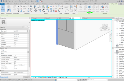

Hi everyone,
I've been reading a lot about the multi wall approach = create a new wall type for each finishing, basically modeling as you build it.
In my project I have a very basic situation: CMU + exterior plaster + interior finish that may vary: tiles or plaster.
So I modeled 3 wall types, one onto the other and joined them.
When I insert a door or window, the opening cut correctly through the 3 walls but:
- in plan and section, walls do not wrap at inserts (obviously...) so the plaster do not return as when I use a single wall type with 3 layers = not a good detail
- in 3D you can see the lines of each wall and the CMU is shown (because it is butting to the window, obviously), no plaster is shown on the four sides of the window opening
Is there a way to solve this problem without using a window trim? My clients don't want any trim on w&d
I guess the answer is in the way the family is built...
I have tried to nest a new rough (empty) opening into the window family but the result is the window floating into a larger void.
I've added a plaster extrusion to this void but, when inserted, it does not cut trough all the 3 walls = not a good detail....
I am surprised that all the people that advocate for the multi wall approach have never encountered this problem.
If so, I could not find a clear explanation on how to solve it on may forum.
Please help with detailed instructions on how to build the window family and/or share your family so I can study it.
Thank you for your help!

Hi!
There are many possibles workarounds here
1 model finish walls in that openings the problem is the bottom face in windows ( is a Nightmare the wall unions) I don't recommend
2 and i think the best is create a normal wall and create parts then is an artesanal work fix the model but is LOD 350 or 400 hard work is included
result
for finishes
GustavoUbriaco_2-1653493041965.pngGustavoUbriaco_3-1653493097743.pngGustavoUbriaco_4-1653493176281.png
draw the border, help from wireframe views and temporary
then extrude that created part to cover that face
Reveal all elements

Thank you Gustavo, the solution looks great, although time consuming.
Is there an "automatic" method? I mean editing the door/window family.
I was experimenting by nesting a clear opening into the family (= the rough opening) and then add a sweep or extrusion to represent the plaster on the inner sides of the openings.
Basically what you did but nested inside the door family
Problem is that that geometry will not join with the finish wall type once inserted and then I'll have to pick lines to make them invisible to look ok in 3D.
Your method seems to allow the opening faces to be actual walls, not just representations, which is great.
Unless your extrusion cannot be considered a wall.
However, the door trims help hiding all the lines in 3D - but my clients don't want doors/windows trims...
Thank you anyway for the input, it's great and well explained and detailed

So far the best result is from nesting an opening into the window family, creating the rough opening, and add an extrusion to fill the gap between rough and window opening. Then it's just boring to turn outer lines into invisible lines - here's only the top line made invisible
It works ok in plan and the rough frame thickness is parametric
But I will explore Gustavo approach too
