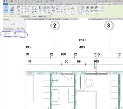

I am having difficulty creating a window tag that orients as the window position. I checked the rotate with component box in window family but it doesn't rotate accordingly. Some help please.

Check the "Orientation" Property of the Tag in the Project  View.

nicol_mukaj
Hi, since I checked the rotate with component the orientation property is frozen. I tried doing the opposite and flipped it in the orientation properties but doesn't work. Maybe I am doing something wrong or I am not explaining myself correctly.

Uncheck Rotate with component and reload.
If "Orientation" is still grayed out in the Properties, then post the file.
