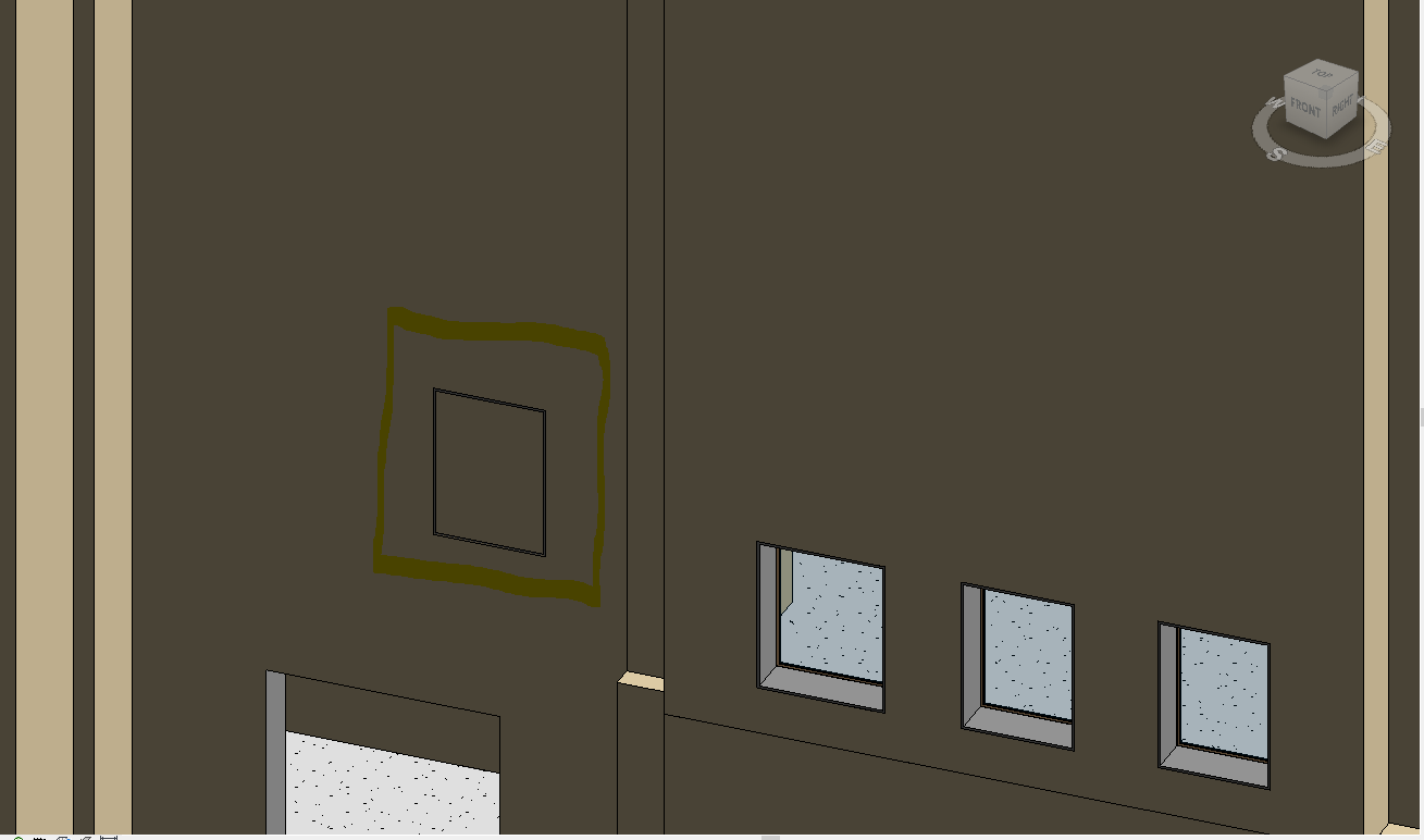

Hi everyone,
Probably, this is such a silly problem, but if I try to add any element such as a window or an opening to a wall it wont cut it.
It shows that the element is there, but its not cutting it.
I've tried placing this element in 3D and in Plan view and its not cutting either way.
I have been using the same elements throughout the entire model, with no problems.
*attached some images.
Any advice?
Thank you 🙂

Check the Phase of the Wall and Window, and your Phase Filters in the View(s)

Thank you so much!
Actually it was my mistake, I had an overlapping generic model by a bit, and didn't catch it!
Smiley Embarassed let me hide now haha.
