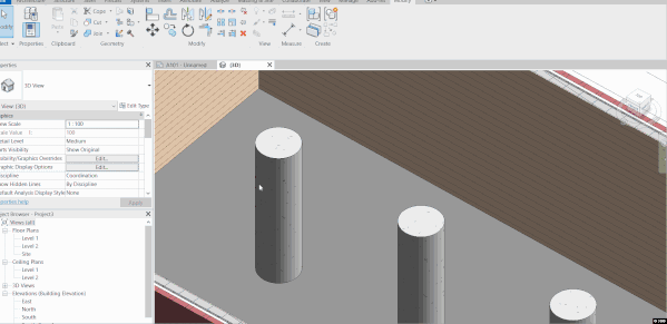

Then paint the interior surface of the Extrusion or sweep. ... I have an old GIF I will look it up and post it
Edit see GIF (This is an In-Place family but the Same principle can be used in a window family)
Message 10 of 12
