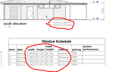

Evening folks,
I'm pulling my hair out trying to work out how to get the 'body text' in my window schedule to be the same size as the text circled in red on the south elevation. I have it set to use the exact same text (Stylus BT 2.0mm) but for some reason its coming out considerably larger in the schedule when I place it on a sheet.
Any help would be appreciated in helping me sort this out please. See screenshots below
Cheers
Dale

You may have override the schedule text font when editing it. Highlight a
row and look at the font properties.

I am replicating the issue
What I would do is highlight the column and then hit reset
Your schedule should reset to the original font

@syman2000  Thanks heaps mate, that did the trick
