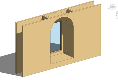

  • I use Opening when the Cut into the Wall is perpendicular on its surface - that's the case for the most of windows I made.
  • But if I need to place the Window (or Door) with the cut at a different angle then 90 degrees (as for instance a church window) then I use one or multiple Voids combined..
An example of a church window

Thank you. My thinking is more into the actual openings. Lets say that they are perpendicular but I need 3 cuts for the window:
1-The actual cut where the frame sits, either with tolerance or not that is not important,
2-The cut on the outside which has the place from the outside of the frame toward the outside which can have an offset from the actual frame, so for example 3cm inset from the actual window opening/void.
3-The inside cut, which can be bigger lets say 10 cm bigger than the window cut.
So we would have 3 voids. If we can't use window opening with voids I guess we have to delete the opening and use voids only?
Message 10 of 10
constantin.stroescu
Opening Cuts the Wall on its whole width , so, yes,  if you want to cut it in steps, then you'll have to use Voids with  depth controlled by parameters
