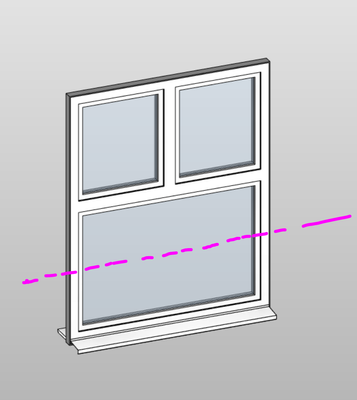

Hi, I would like to ask for your help with an issue I am facing with my custom made Window Family and its florplan display. I am currently working on window families, that have quite high level of detail (user requirement). I am using nested families for frame a casements. It works good, exccept for the families, that have casements above each other. For example:
The problem is, that this kind of window should be displayed in floorplan in this way - screens are from RVT project file (no middle verical frame element, no upper casements):
But instead of that, it looks like this (middle vertical frame element, upper casements - the elements that are not insterserting the horizontal cut plane):
Please note that I made myself sure that the horizontal cutplane is set in correct position. I went through a lot of forums posts and tried some solutions for this isuue (but unfortunatelly unsuccessfuly).

Hi, thank you for your answer. I appreciate that. Unfortunatelly, I am not sure if you understand my problem. The detail components are just part of the nested family (I mean the casement arc). I think that we might actually ignore those in this moment). What I need is to generate the floorplan symbol (mainly the profiles of frame and casement) directly from the 3D model. In other words, i would need to see these elements displayed in floorplan exactly like the horizontal cuplane is intersecting them:
But, I am getting these elements despite i should not (1-middle frame profile, 2- upper casements):
But in the Family editor, it works like it should and I do not understand why.
The nested Families are modelled as sweeps with profiles.  I read somewhere, that this may cause the problems, but I was not able to find any further info.

What I would like to emphasize is that my main concern the floorplan symbol generated by the panel and frame profiles. I do not get why the family looks different in the project and in the family editor:
Project (rvt)
Family editor (rfa)
This issue is decribed in greater detail in post 6. The main questions I have and I need to resolve are those:
  1. why the family (floorplan view) looks different in rvt file when placed and in family editor?
  2. what difference I can make in the family or nested families in order to prevent this issue?
Many thanks for your help!
